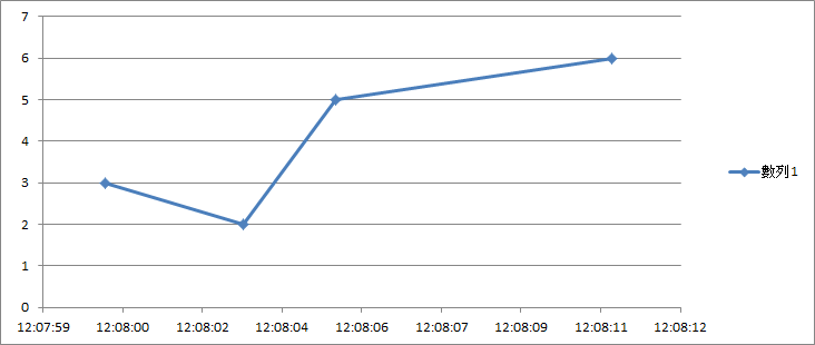

How to plot a chart with the time interval not fixed?
I know this question is a little stupid..., but I'd still like to know how to realize it...
If the signal is generated randomly by time, how to plot it in the chart since its interval must be fixed?
like the following image
I think XY Graph might realize it, but it is not what I want since the signal is generated continously for a long time.
I hope the data will be updated as the chart mode, is it possible?
