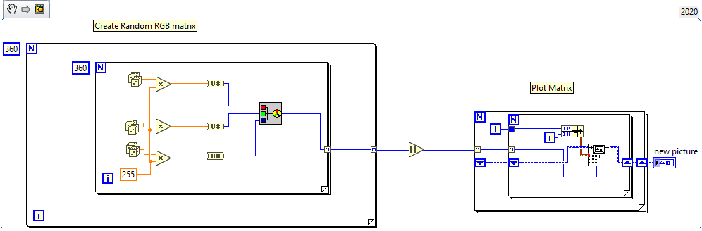

How to plot a image of 2d matrix
I have a matrix of  360x360
I want to plot an image of this matrix

Do you have the Vision Development Module? Without it, you can use the Draw Point.vi, as shown in the next VI snippet (to use it on your VI just download it and drag and drop into the block diagram).
With the Vision Development Module it should be easier, first creat an image, and then use the pixel manipulation VIs to modify the values according to your matrix and display the image, but I am assuming you don't have it.

what is the name of this control funciton
(2,313 Views)
That is a bundle, you can find it under the Cluster, Class, & Variant VIs and Functions palette.
