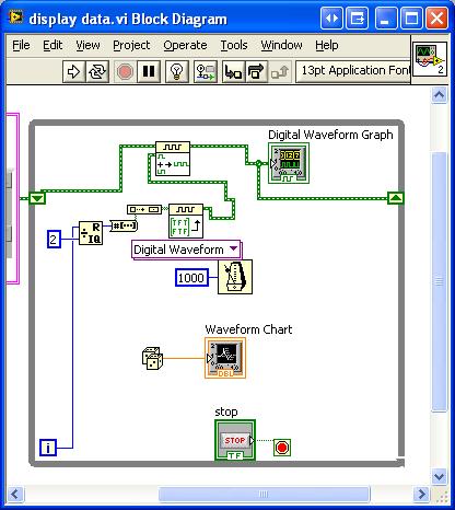

Hi Everyone, Can anyone lead me to board/question that has been post in this forum related to plotting graph from numeric values obtained.
From the attachment, I would like to plot graph (data vs time) based on all numeric output values obtained from the signal. This 'numeric' values are data that has been decoded from Sample Hi Data and Sample Lo Data values.  Can anyone give me lead or hint for me to do this.
thank you in advance for all suggestions.

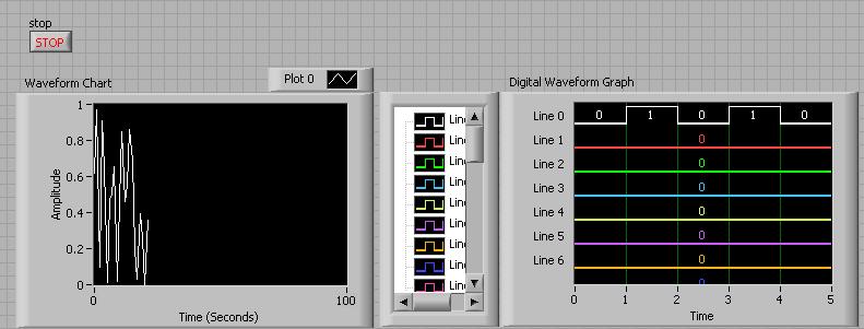

I have attached some example code in LabVIEW 8.6.
You can display numeric data by wiring it into a chart. A chart will store all is values until you reset it. Because of this, its ideal for being within a while loop. You can also you a digital waveform graph to display digital data.
To display current time please refer to knowledgebase Displaying Current Time on a LabVIEW Chart.
I hope this helps, please let me know if you have any questions.
