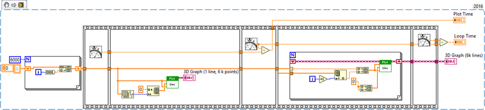

  • Objective: Plot a large number of lines (6000 for this example). Each line is described as an independent segment with the start-point and end-point coordinates. The lines are not continuous between them, but I have included an example with continuous lines to reproduce the problem and simplify the code.
  • Problem: Drawing 6.000 lines on the 3D line graph freezes the system (tested on LabVIEW 2016 64 bits, 2017 64 bits,2017 32 bits).
Please find attached a simple code to reproduce the problem. In this example, the 3D line graph is used to plot a single line described by 6000 points with excellent performance. However, my objective is to plot independent lines without connection between them, so the second 3D line graph is intended to plot the same line with this approach. In this context, 6000 line objects are stored in the graph array in short time (25 ms approx.), but the LabVIEW interface freezes for a few seconds (5 s approx.) when the indicator is fed with the data. The poor performance of the 3D line interface produces an unusable application.
As the same line is rendered for this example, both figures should have similar computational time. I'm wondering if there is some computational overhead when multiple objects are plotted.
How can I tackle this obstacle and achieve the goal?

I modified your code a little bit (to get better timing accuracy).  I didn't realize you were talking about 3D line plots (which are much more complex than 2D graphs).  Plotting one line of 6000 points takes about 113 microseconds.  Plotting 6000 lines of two side-by-side points takes 24,829 microseconds, roughly 200 times slower, but still pretty darn quick!
Here's my (revised) code as a Snippet  (LV 2016).  I'm using the High Precision Elapsed Timer ...
Bob Schor

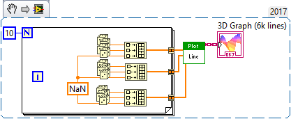

Try inserting NaN between lines X0,X1,NaN,X2,X3, ... Y0,Y1,NaN,Y2,Y3,... Z0,Z1,NaN,Z2,Z3,...
This creates 9000 points, but is still faster then 6000 plots...
For me:
Points: 0.14ms
Line plots: 34ms
Line with NaN 3.9ms

Many thanks Wiebe! Your approach seems to be working with excellent performance.
Message 8 of 8
