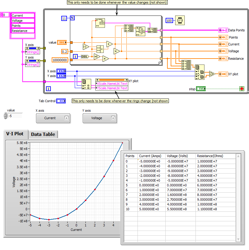

Most of your code seems flawed, so I took the liberty to clean it up a bit (Of course I understand that your data probably comes from elsewhere and this is just a simulation. Still it might give you some ideas).
  • There is absolutely no need to maximize the front panel to the screen.
  • If two cases differ only by the sign of one diagram constant, you don't need all that duplicate code!
  • In addition to what Gerd showed you, you also should update the axis labels.
  • I prefer complex arrays for XY graphs. Same difference!
  • Since your two rings should always have matching entries, you should make sure they do.
  • Make sure that all controls have typical default values.
  • If you want to select the axes during run, you probably need a toplevel while loop.
  • You probably want more reasonable formatting of the table. (not shown)

According to your code, first we have to select the axis then waveform will be generated according to the selected axis.My question is, after the execution of program,how to get different plots by selecting the different axis i.e. at a same time we can get 12 plots by choosing from ring menu e.g R v/s I, R v/s V, R v/s R, R v/s P and same for others. I have attached a video of what i want to do

  • according your code, i can change the axis es while running the code and get the desired output waveform.
  • but i want to change the axis,once the code execution completed.Kindly go through the video that i have uploaded.
