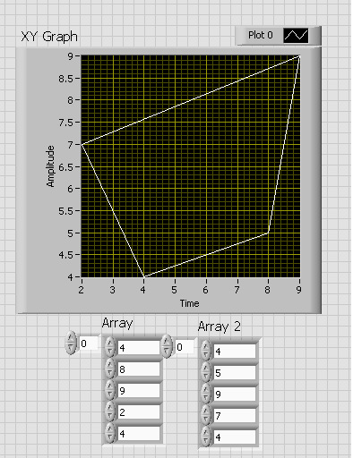

How to plot this curve ( R-X curve for a distant relay )
The file is attached.
(2,269 Views)
Hello Sukhmeet,
It's fairly simple to make.
Just use the XY graph and two arrays.Remember to make the first point also the last point otherwise the line will not connect.
