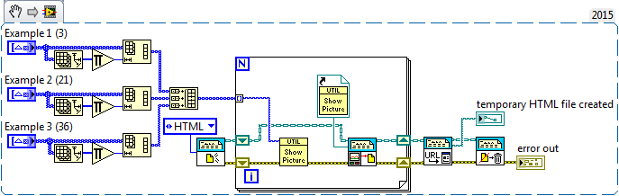

Well, I partly managed to do a "Page-by-page".  More-or-less for "Proof of Principle", I made an HTML Report that simply printed all of the Pictures one after the other.  One "problem" I had was that there were no page breaks -- the plots just came one after another.  Another (minor) bug is that LabVIEW gave me a "File not Found" error when I tried to save the (new) HTML file, so I substituted a "View HTML in Browser and create Temporary File" (which I didn't bother to write out).
I do all of the "magic" with the RGT, of course.  One small piece of the magic is the sub-VI "Show Picture" -- all this does is display on a Picture Control on its Front Panel the picture you pass to it, and we then write that Front Panel to our HTML.  Pretty sneaky.
While this is saved in LabVIEW 2015 (and I think you are running LabVIEW 2013), it is simple enough that if you have the RGT, you should be able to reproduce it.  I've already told you the sub-VI "Show Picture" does nothing except slap the Picture input onto its Front Panel (nicely covering up the Error In and Out).  The code at the beginning is to turn your 2D arrays of pictures into 1D arrays and concatenate them so I can use a single For loop and just run them all.  I'll attach the resulting HTML file -- I'm not sure how Image Order is maintained, but that should be simple to adjust.
[In getting the HTML ready, I realize that it created 60 JPegs, with the HTML being "Display my JPegs" -- probably not what you want!  But the principle of iterating through a series of Pictures, getting separate Images with the RGT, and putting them somewhere, still applies.  More fiddling may be needed].
