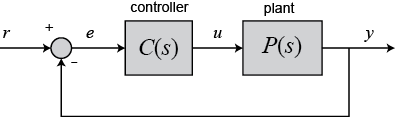

Typically, you would produce a modelling diagram which has blocks for your plants/sensors/actuators/controllers and shows the inputs/outputs of each block and how they relate to each other for your system.
This is pretty much the simplest example I could find for this:
r is your setpoint
u is your control input
y is your output
e is the error between your setpoint and output
C(s) and P(s) are your controller/plant models as transfer functions
