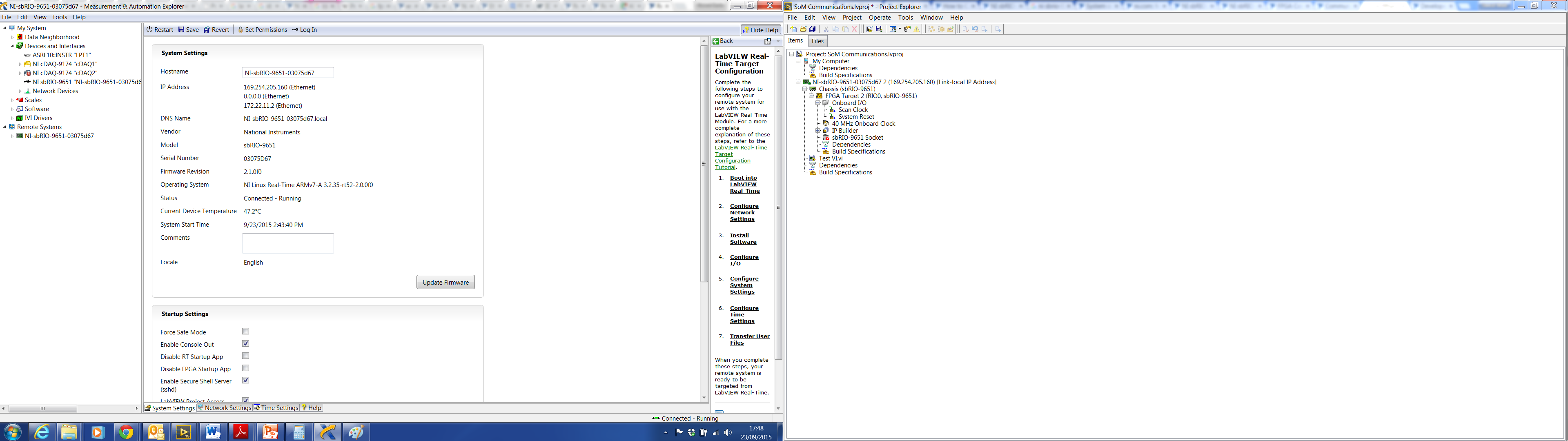

In MAX my hardware only appears in Devices and Interfaces and gives me no configuration options at all.
In the tutorials they are talking about ocnfiguring IP addresses in the remote systems section.
EDIT: Another difference, when I choose my hardware in the project area of LabVIEW, I don't get an option between real time and FPGA. It seems to automatically go to FPGA for me.

Which bit are you struggling with, specifically?
I don't have the SoM drivers installed so I can't give you the exact instructions but....
Create a project and add the SoM as a target (right click project New -> Targets & Devices).
You should be able to add the FPGA and then add your I/O under that (or add the reference board which might give you the lot?).
What do you see in the project now? Can you take a screenshot of the project window with the SoM?

I have got as far as seeing the FPGA in my project folder. How do I add the I/Os?
Message 10 of 28
