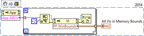

What happens when you run this code? (I'm not too sure about the "2" operator. Maybe try with and without it.)

The App.AllVIs property, which I wasn't aware of, looked promising but it proved unsuitable in this case.
I wrote a test VI which calls my re-entrant error window and then executes the  App.AllVIs property. I tested two cases.
Case A) called one error window statically and two error windows dynamically
Case B) called two error windows dynamically
In each case, the App.AllVIs property executed 3 seconds after the error windows popped up and the test VI went on to run an empty dummy loop.
In each case the App.AllVIs property returned the name of my error window just once in its output array.
So it would appear that this property returns the name of a VI just once (if it is loaded in memory) regardless of how many instances of that VI are open during runtime, and regardless of whether those instances were called dynamically or statically.
I haven't used the rest of the code in your screenshot as that would have just returned the bounds of over 2500 VIs in memory, which was not necessary anyway.
