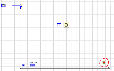

Sorry that I did not make clear it is a parallel FOR loop that I am talking about. The subVI is just as simple as that, but I cannot add a conditional terminal to the loop, so I need to find another way to interrupt the loop.

See image as example . Simple Local variable used to detect an situation and then skip all remaning "actions" in all Parralel instances
Floris Reinders

Can you not just add a 'Conditional Terminal' to the 'For Loop'
Message 7 of 15
(3,966 Views)
Nope it will leave a broken arrow
Message 8 of 15
(3,953 Views)
Only if you leave it unwired.
Wire the local that flas the stop to the terminal and it will prevent the loop from iterating instead of spinning and devouring CPU as it counts.

That's not what I see.
