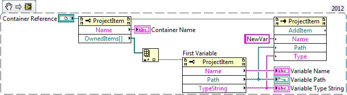

I have successfully used something like this to programatically add shared variables to an LVLIB (the code assumes that the library associated with the Container Reference contains at least one variable):
An example output would be:
  • Container Name: "MyLibrary.lvlib"
  • Variable Name: "Variable1"
  • Variable Path: <blank>
  • Variable Type String: "Variable"
(I notice that there is no way to specify the data type of the variable, and LabVIEW creates a DBL variable in the LVLIB by default.)
However, if Container Reference is associated with a "User-Defined Variables" container, then I get Error 1 at the Invoke Node ("LabVIEW: An input parameter is invalid"). A example output is:
  • Container Name: "User-Defined Variables"
Questions:
  1. Does the error occur because LabVIEW is trying to create a DBL variable (which is not allowed with UDVs)?
  2. How can I programmatically add UDVs to my project?
Thanks in advance!

@kabooom wrote:
Did you find any solution?
Unfortunately, I didn't find a way to add UDVs to a LabVIEW project via VI Scripting, and I stopped trying.
