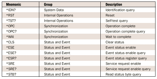

Well you could see if it responds correctly to a couple 488.2 common commands.
IEEE 488.2 Mandatory Common CommandsIEEE 488.2 Mandatory Common Commands

Then those instruments are probably 488.1 compliant, not 488.2 compliant.
For an instrument to be IEEE 488.2 compliant it MUST respond to the list of 488.2 Common Commands I posted above.

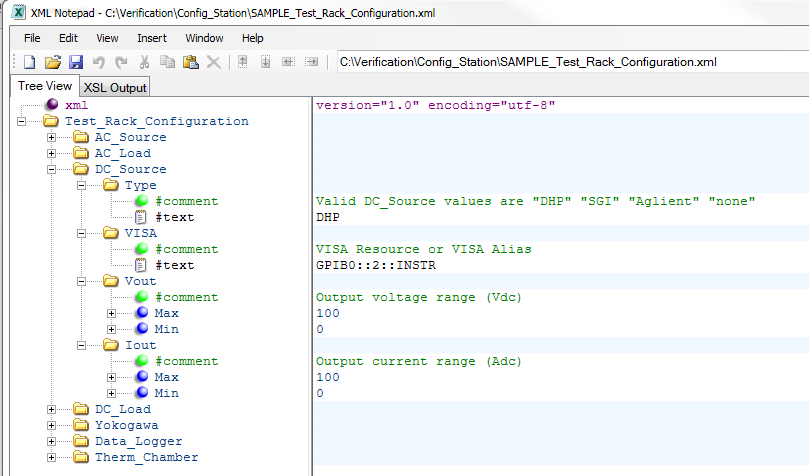

Granted I don't know what your application is but what I have done in the past to make a program more "universal" with various pieces of test equipment from the same or different manufacturers, is to put all of the "drivers" necessary for all the possible instruments in the program and use a config file to tell the program what drivers to use.
For instance we have DC sources from Agilent and Sorensen in our test racks, also there are two different series of Sorensen sources that use different LabVIEW drivers (DHP and SGI).
Here is an example of my configuration file section for the DC Source.
Notice I also have the VISA resource and the instruments output parameters in the config file.
This file gets read and values put into a cluster for use in my program.

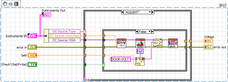

Here is one of my VI's that sets the DC Source output voltage.
All of the VI's for all three source types are in this VI.The DC Source.Type output of the Instruments cluster sets what VI's are used.
