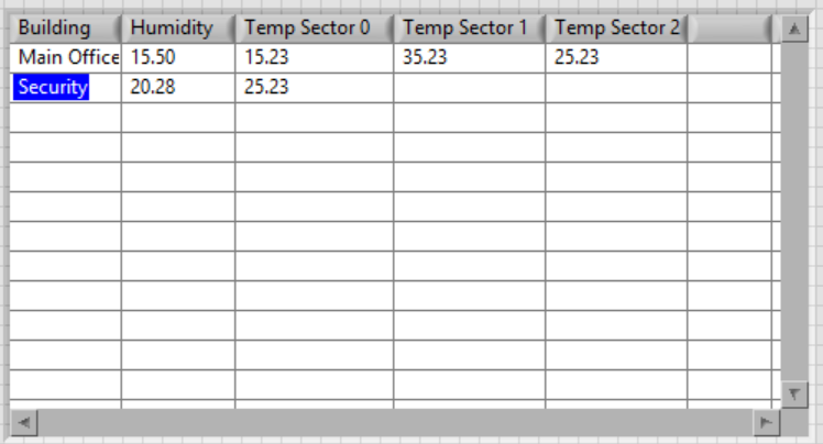

I want to write a vi where the user can view this data in two formats as 2D Array with the latest measurement info like so:
Desired ResultDesired Result

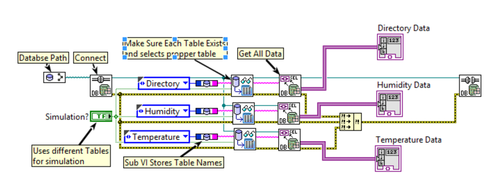

Right now, I've got this as my Vi that displays all data on each table,
CurrentVi.PNGI understand from other forums that I need to put something equivalent to

Use the "DB Tools Execute Query" VI on the advanced menu to execute a custom query.
