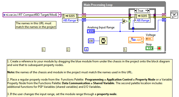

The scaling individual I/O channels on cRIO cards can be set at edit time through the shared variable properties dialog box.  Is it possible to access this programmatically at run time?  I have found the "Programmatic Module Configuration - Scan Mode" in the example finder.  NI-Programmatic Module Configuration.PNG
It shows simply connecting an IO reference to a property node, however the scaling is not one of the properties - only Range and Terminal Mode are available properties.  Also, the method shown does not seem very scalable.  I would like to be able to programmatically set scaling for all the analog channels on all my cRIO cards... 96 total. The use of a loop, shift registers and a compare seems a little less than elegant.  Could this be done with some sort of event?
