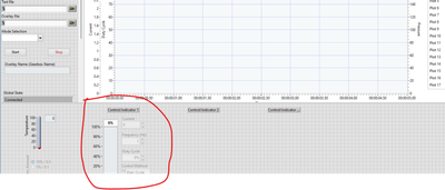

How to programmtically build controls indicators that are grouped together.
I Basically have a group of controls/indicators where the number that exist change from a text file that is read.
The Data is also controls and indicators, so i have to be able to individually enable/disable them and uniquely update their captions, which is why I don't a simple array would work. How can I programmatically create these controls and indicator groups (up to 12). That are spaced evenly and can be unqiely controlled (programmatically) after creation? OOP? Xcontrols?

Hi eli,
you cannot programmatically "create" controls in LabVIEW.
But you can create them at edit time, hide them programmatically on the frontpanel and show them programmatically when needed!
