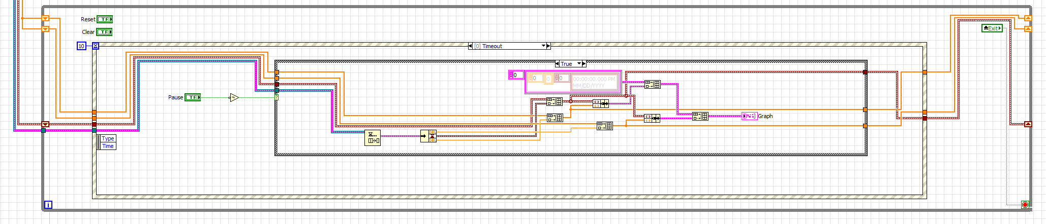

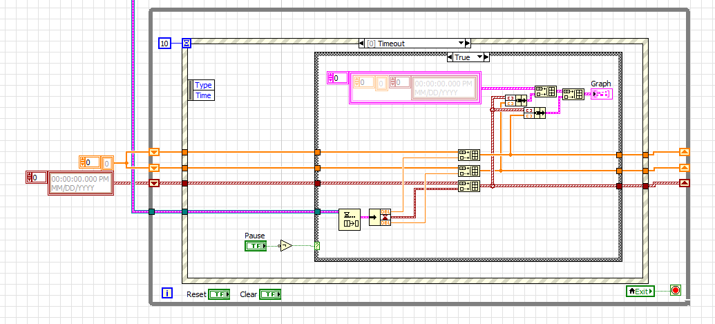

To start with, don't use clean up block diagram, that always makes a bigger mess than it started with.
Before:
After:
You need to be disciplined to keep it organised from the start and don't let it get out of control.

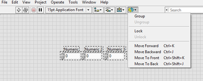

If you want to organise the controls in the front panel then you should use these options.
And for the lock and group part. Select all the controls you want to lock position or group together and select the option.
