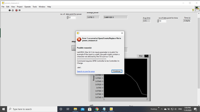

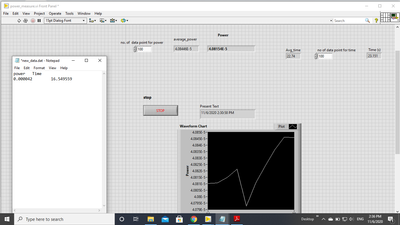

Dear RTSLVU,
Thanks for your reply. I did what you suggest to me. I got a problem. The file contains only one data point ( I guess it is the last data point measured by the sensor), and how can I get all the data points as measured by the sensor?
How can I put the header in the correct spacing?

Dear GerdW,
Hi
I used the plain text function to save the data. However, I can save only one data point. How can I save all the data point as measured by the sensors?

Hi prabesh,
wh
@prabesh99 wrote:
Dear GerdW,
Why do you open the file inside the loop inside the case structure? We told you to create very different code!
Why do you close the file inside the loop?
Why is there a "default if unwired" tunnel holding a file reference?
Why is there no error handling with your file functions?
Again:
Have you examind any of all those example VIs coming with LabVIEW?
Why do you write two answers with attaching a VI using the very same filename, but with different filesize? That is very irritating (and annoying)!

@prabesh99 wrote:
Dear RTSLVU,
Thanks in advance!
I guess I was not clear enough...

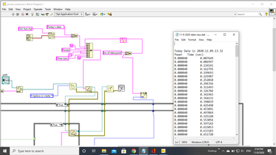

Hi RTSLVU,
I did what you said, and now the problem is that I don't get data in scientific numerical. How can I get data in scientific numerical? Another question is, I want to make the given input integer in the header, but I could not make the header from the format into string VI.
Thanks in advance!

Hi prabesh,
Read the help on format strings. Right now you use "%f", but there are a lot of other format codes…
Are you talking about "no. of data point for power"?
Place the terminal of this control before the case structure, then you can use its data for header generation…
(This is basic THINK DATAFLOW!)
