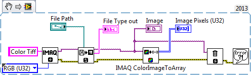

IMAQ ImageToArray VI can only read grayscale images. For color images (including TIFF type), you can use IMAQ ColorImageToArray VI. Below is an example that works, and the screenshot of the resulting front panel is attached.

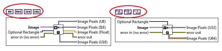

You can check the supported image type for evey IMAQ VI by clicking the detailed Help and check the icons above the VI image as seen below (red highlight), or check the compiled summary ("Supported Image Types").
