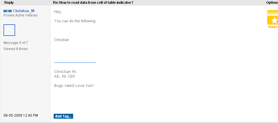

Hey,
You can do the following:
code
Christian

Hey,
code
Christian

@muks: No, ...screenshot should be enough to see how it can be done.
Message 7 of 12
(3,970 Views)
But where is the screen shot?
Message 8 of 12
(3,967 Views)
Accepted by topic author Shrini
Strange, I can see it with different accounts.
ok, attached the VI.
Christian
