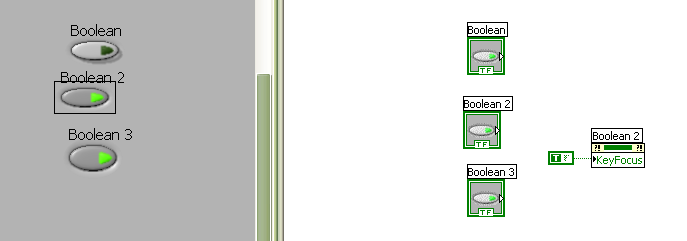

Message 3 of 26
(3,767 Views)
I mean the cursor (check out the attached picture) . I have no idea what "key focus" is and how to use it?
Cheers,
I G.
Message 4 of 26
(3,766 Views)
Yes, Means I guessed it right. Use can use the property node similarly for string control.
Message 5 of 26
(3,757 Views)
Accepted by topic author igurov
Hi again,
I have tried this but nothing happens. No effect at all.
Message 6 of 26
(3,751 Views)
Solved. I was using an indicator instead of control.
Thanks!
