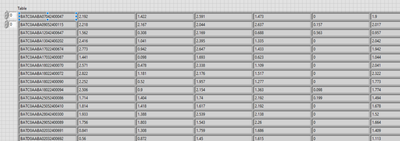

This is Vi
This is the out. Everything is ok except Header name. Serial Number
csv file out put
Expected csv out put as below. Check Highlighted color
Message 13 of 28
(1,152 Views)
Create an Array of String that has what you want in the Header Row ([Serial Number, S1, S2, ... S40]).  Before you write the 2D Array of all of the Data, write the 1D Array that is the Header Row.Formatted Header.png
You do two writes -- one for the Header Row (here with "Serial Number" in the first column and then 20 columns S1 to S20 (you can make it 15, or 30), write it to the Output File first, then write all the data files as you have accumulated them.

@Maheboob wrote:
This is Vi
You don't need to wire all these indices, the 29 is all you need. Don't clutter the diagram!
Even simpler, just do the array subset!
If you want headers, use another built array before writing the file and wire a 1D string array containing the headers. (A string array diagram constant if they are fixed, or else read from wherever that info is kept)

@Maheboob wrote:
Dear Bob,
Please find my VI.
This is based on my suggestion, not Bob.
 I already told you how to write the headers. I can't tell you where to get them because I don't know where the are.

@Maheboob wrote:
I am new to LV, just I know the basics of LV. I tried with your suggestion but it not working.
There are billions of possible ways something is "not working". You need to be more specific.
@Maheboob wrote:
All serial numbers appearing before column. Can you create VI for me from my last VI to get the header names. Please refer my earlier email and attachment. Thanks
I don't see any emails and this is a very long thread with many conflicting statements. Assuming the header you want is just [Serial Number, Sensr1, Sensor2, ... Sensor 10], here's one possibility:

Accepted by topic author Maheboob
Here I use an array of files (I repeat the same file here, because you only attached one. You will have an array of file from "list folder", as shown earlier, of course and all files will be different)
