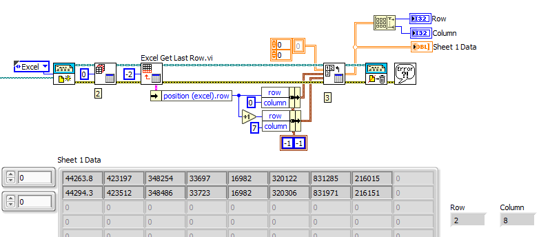

You can get the position of the last row using "excel get last row" and calculate the start and end positions from there. May need a tweak or two, nothing a +1 or -1 cannot fix. 😄
