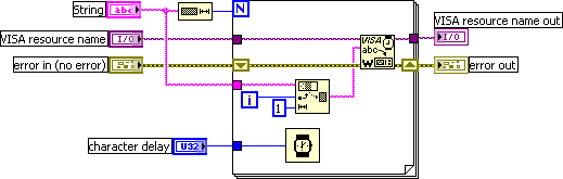

I will try to send the Bytes seperate as well in LV but I don´t know how to write the Loop.
Is there a good example for that?
Cu, Rich
Message 12 of 14
(897 Views)
Try this. The function inside the for loop is String Subset.
Message Edited by Dennis Knutson on 05-29-2007 09:36 AM
Message 13 of 14
(894 Views)
