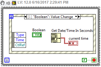

Get Date/Time in Seconds
aputman
Message 2 of 10
(5,579 Views)

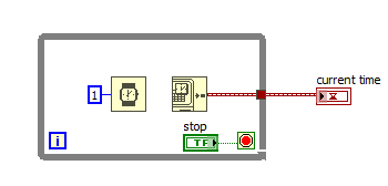

Or if you are not into Event based programming you can poll in a loop.
=== Engineer Ambiguously ===
Message 3 of 10
(5,544 Views)
aputnam,  Look at the left hand side nodeSmiley Wink
Message 9 of 10
(5,456 Views)
@JÞB wrote:
That's the same as "tick count", and only useful for relative measurements.
Message 10 of 10
