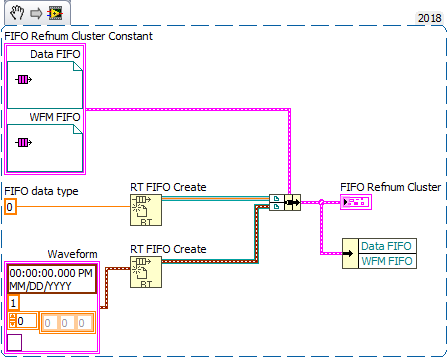

That example is intended for LabVIEW Real-Time. Maybe I did not get the question but is this helpful?:
You need to wire the type first with the desired data type and then right click on rt fifo refnum output and create constant or control. You can then copy the constant/control and paste it on your FIFO Refnum Cluster.
Lucian
CLA
(2,741 Views)
Thanks LucianM. Yes, this was the root of my question. I was incorrectly creating the FIFO refnum constant before (and not after) wiring the desired data type for each individual FIFO, which in my case were all unique data types..
