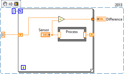

Since you're wanting to take two consecutive measurements with some number-crunching in between, you can just use a for loop and a shift register, like this:
Just insert your sensor VI for the control and your number-crunching for the "Process" formula node.
[Unsolicited advice] Oh, three things for general LV programming use: take out the flat sequence structure in your picture, you don't need it since your dataflow is determined by the error wires, try not to have all those jags in your wires, and avoid putting wires behind opaque things at all costs. [\Unsolicited advice]
