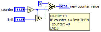

Hi Orta,
you should have had the time to go through all those FREE online resources offered by NI for LabVIEW beginners…
Conversion of my pseudocode to LabVIEW G:
