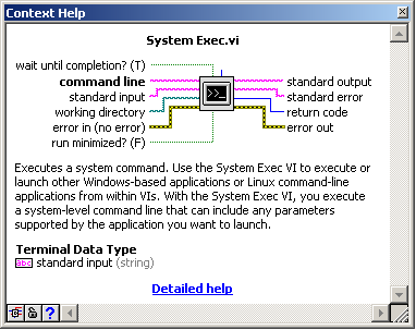

You could choose Sys Exec from application pallete to run your exe file. There is an option to wait for it till it completes execution. If you indicate "T" there, and then wire your controls after that (via ERR Cluster), I think you should be able to enter inputs. Is this what you wanted?

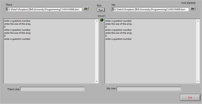

Sorry for my first explanation the my English
i will try again
i started to learn C in the university
we need to make Program that run in the cmd,
the tutor take the output of the code and copaire it with there program output
the problem is if you forgat to add ":" to space they lower your graze, and want to prevent that by write a program in labview .
the program will get the path of the tutor exec and my exec.
and when i enter an input the program send it to both of the program and compare the output.
now i send the output to txt file of both program and compare it with my program
But i want to make my life easer
i traied to send that commande to the cmd via Labview  echo "1 2 3" | my.exe
but it's not working.
i hope i explain my self this time
thanks for your replay

Are you not able to use Command Line and Standard Input to do the job ?
Command Line: cmd /<File name>
Standard Input: echo "1 2 3"
The other option is creating a .BAT file. http://www.computerhope.com/batch.htm#11
You can enter the commands you want in your batch file and call it via Command Line: cmd /<Batch file path>
I think the second option will definitely work.

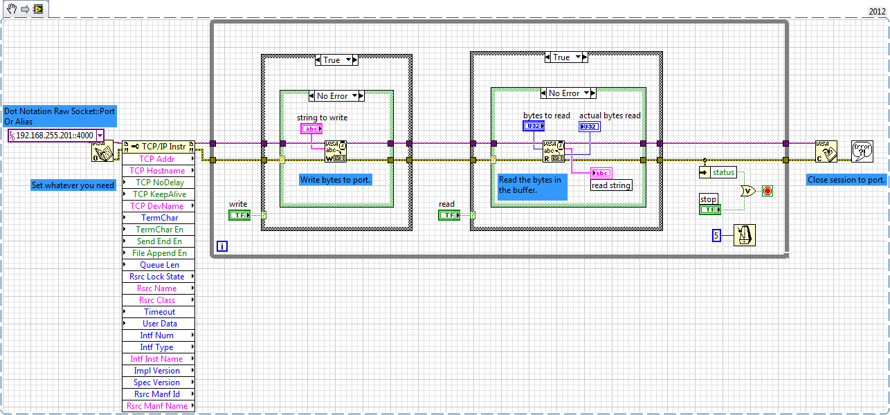

I'm using Tera Term to connect to an IOLAN via TCP. So I currently have a TCP read write function going on and that's fine. However, I'm not that great of a programmer and I don't know how to exactly emulate a terminal/console. I want to be able to see what is going on in the console in real time and also be able to respond. Perhaps there is some avenue I haven't explored in LabVIEW.
Message 8 of 9
(4,283 Views)
A quick edit to the "Advanced VISA Write and Read.vi" Shipping example (Don't blame me its a shipping example) to modify it to use a TCP/IP:Instr class VISA Session should give you some idea.
