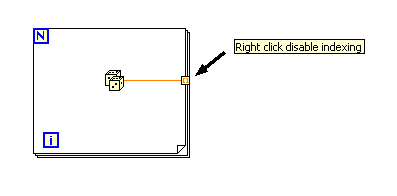

You can save it to a local or global variable but it is bad style.
A shift register is not necessary in all cases. You can often just wire straight out of the loop. If it's a for loop, you just have to disable autoindexing.
