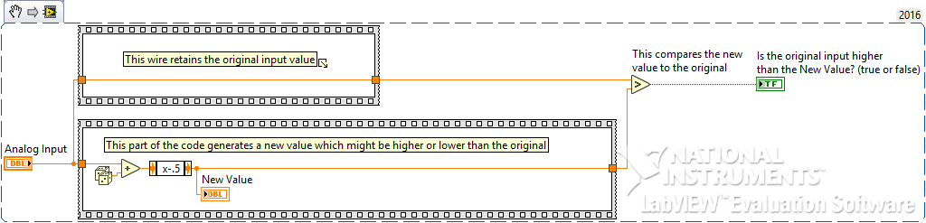

When you say you want to save the data "for future comparison", does this mean you want to save it in a data file, so you can go back and look at it days, or months later... or you just need to store it in memory while the program is running?
The example below shows how to retain the value of an input for future comparison.compare to input.png
Please let me know if that helps.

In this version, I have added a "Sense Flame" sub-vi inside the loop, so it compares the current value of the flame sensor to the previous maximum.  That way you don't have to "revert back" later.
My "sense flame" VI is just a random number generator. You should replace it with code for your flame sensor.
I also added a chart, so you can see where the maximum is. One problem I foresee is that you might hit a maximum value and then never quite get that high again, so you'll want to be able to see not only when you're at the max, but when you're approaching it and at a value that is reasonably comparable to it.
