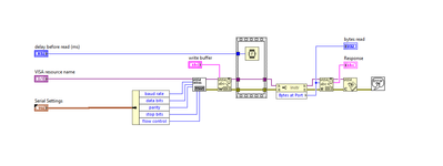

Hello everyone,
I want to send a command to a serial device. The connection works, but it sends false commands. Can anyone say what is the problem? Command is 0X0211EE0X03
Message 7 of 13
(3,119 Views)
Hi Sina,
@Sina6611 wrote:
Hello everyone,
Well, we don't have your VI, we don't have your hardware/device, we don't have a manual for your device…
What I can say from your image:
  • When the message contains just one byte ("11") then you don't need an array control: a scalar control would be ok.
  • When this "11" value should be hexadecimal then you need to input 17 (as 0x11 = 0d17) into your array control - or switch the numeric formatting of the control to hexadecimal (and show the radix!)!
  • When using such "hex" messages you most often should turn off the TermChar option for your serial communication! Or use the correct TermChar, which should be 0x03 in your case.
Did you already watch this video?
And PLEASE don't create multiple threads for the same question/problem!

thank you for your answer.
My message is 0X0211EE0x03
How can is send it to device?
Message 9 of 13
(3,103 Views)
Hi Sina,
No need to ask the same again and again:
I repeat from my previous message: show the radix/display style for each numeric/string control/constant used for building your message string! (After showing the radix it's much easier to set/use the correct radix…)
Btw. you should write "0x02 0x11 0xEE 0x03" to make clear EACH byte is written in hexadecimal encoding! You present a string without any spaces in between, one "0X" and one "0x" (uppercase/lowercase X), the "11"/"EE" without any radix at all - all this makes it harder to understand your issue!
