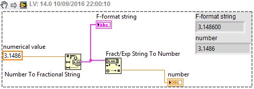

I hope you want to send letters and not litters 🙂 Anyway, as you have noted, you can only send string using VISA Write. Same for VISA Read, you get string. The solution is very simple: use the string-number conversion functions (Number/String conversion subpalette). For example you have an "angle" numerical value, you need to convert this into a string, and send it. On the receiver side, you can convert the string back to number if needed:
