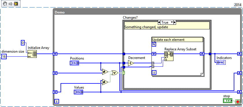

I am not fully understanding the question, but you should always work with arrays as much as possible. You can always index out at the end of you want seperate indicators.
Here's one possible interpretation to your problem, maybe it can give you some ideas.

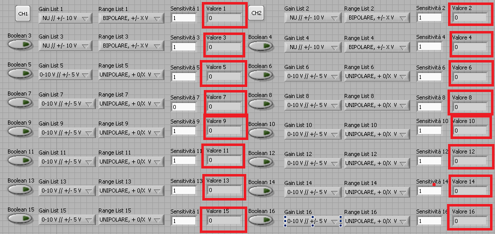

The problem is that I don't have only one array to fill but 16 different indicators, in different positions on the panel, and I want to choose which of these fill.
I attached here an image of my actual panel.
The goal is to fill the numeric indicator (red square) of the channel that is active in a specific test.
When I activate channel 4 and 12 I want that their actual values appear, during acquisition, in the indicators in their respective sides.

As Altenback said in his post, you can use index array and wire it to separate indicators.

....alternately you could always fix the design of your user interface. That GUI is is guaranteed to confuse and irritate people -- as well as create errors.
There is way too many numbers and buttons and things.

Thank you very much!
I've modified my program to work with arrays and now the problem is solved!
