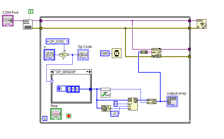

I take a control on front panel which is used to change which Op_Code needs to be send.
Then based on the Op_Code selected in front panel, i created packet in case structure which consist of Op Code + Data Bytes.
Then Out of case structure i calculated the XOR Checksum of the OP_Code and Data Bytes.
Then i calculated the length of packed and add it to the data coming from case structure along with header.
Then i combine the checksum and then send it over serial port every 1 sec.
Here is the block diagram.

Don't use Insert into Array if you are putting data into an array at index 0.  Just use Build Array.
No need to have the Visa Write be on a wire branch for the VISA reference and error wire going across the top.  Those wires should go THROUGH the VISA Write.
Doesn't your checksum require all the bytes up through the data?  Righ now you are only putting the checksum on the data bytes and forgetting about the opcode and length bytes.
Your not sending the opcode for Opsync or Opfuture.  You are just sending empty arrays.  Meanwhile for the other two, you put the opcode into the data array.  Just wire your original opcode wire into the Build Array.  Get the data element out of those case structures that is supposed to represent the opcode.

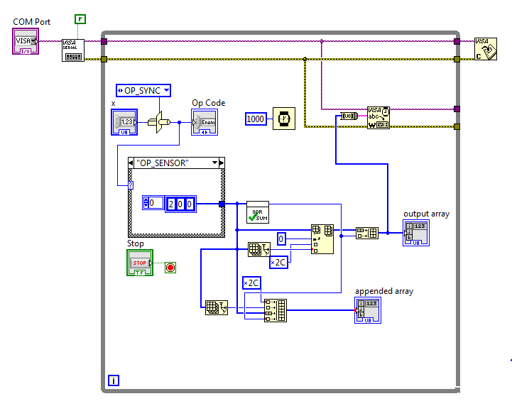

I modified the block diagram and here it is updated block diagram with both previous one and using build array only, but why it contains to many red marks. Good thing is that it is working fine.

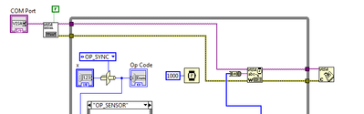

Okay, so what i understand is that, connect VISA Reference and error to Write Block and then to Close block, no need to go directly.
Like this

@xpress_embedo wrote:
 The red marks are called coercion dots.  It is telling you the datatypes don't line up and some need to be coerced to another datatype.  That datatype will be the one that can best represent the most numbers.  Because array size gives an I32, all the U8's get coerced to an I32 when going into the array.  Then because you are displaying that into a U8 array indicator, they all get coerced back.
Attached is a cleaner form of that code.

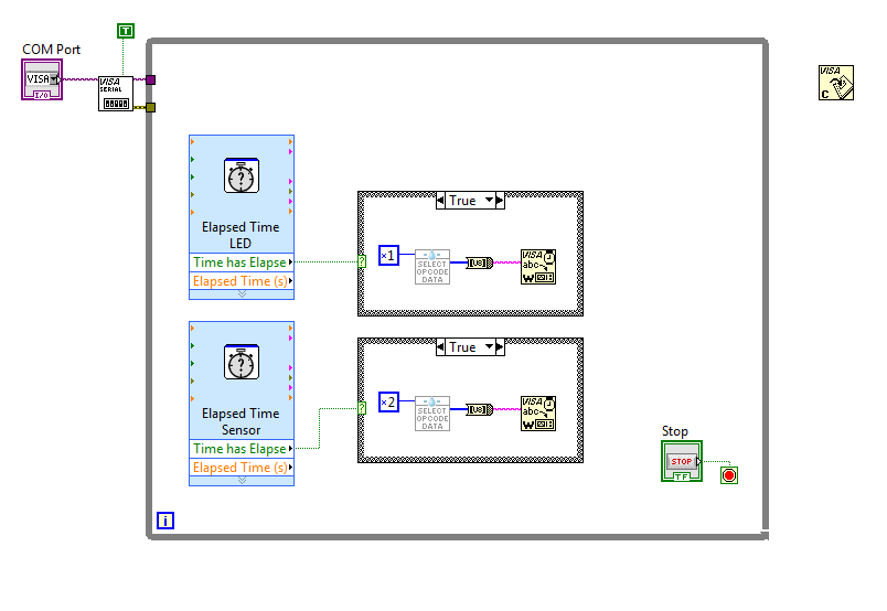

I created sub vi and then using elasped time express vi to schedule when packet is going to be send.
Am i doing it in right way as it is creating confusion in my mind.
Like where do i place serial write, whether it is outside the case structure or inside the case structure, if i place it inside the case structure then i have to provide some data in False case as well, which will trigger some packet on serial port.
Please suggest what could be the best possible way to implement this.
Yes, put the VISA Write inside of the case structure.  You just wire the VISA Resource straight through in the false case.
Thanks for that help.
But now i am confused.
Another question, which is just for knowledge though it is not impacting anything.
1) Why my SUB VI borders are light in color.
2) How to align the input and output terminal.
This is a study in how to ignore data flow principles.  😉 Just because "VISA Close" is to the right of your loop doesn't make it execute after the loop.  Because it isn't wired to execute after the loop - or after anything, actually - it will execute whenever it wants - and probably before you want it to.  Your elapsed time express VIs are not wired to execute after anything, so either one may fire first.  Similarly, the two cases aren't wired somehow together, so either one may execute first.  Similarly, that means any of the "VISA Write" nodes may execute first - definitely NOT what you had in mind.
A more subtle gotcha is that if "Select Opcode Data" isn't set to execute re-entrantly, one instance will have to wait until the other has completed before it can execute.  In the vast majority of cases, this isn't a problem, but if the VI takes a while to execute, it may unnecessarily slow down the application or it may mess up timing.

Put the Byte Array to String and VISA Write inside your subVI.  Everything about how to formulate a message and the actual writing of the message should be encapsulated in the subVI.
(Why'd you change Enable Termination Character from False to True?)
