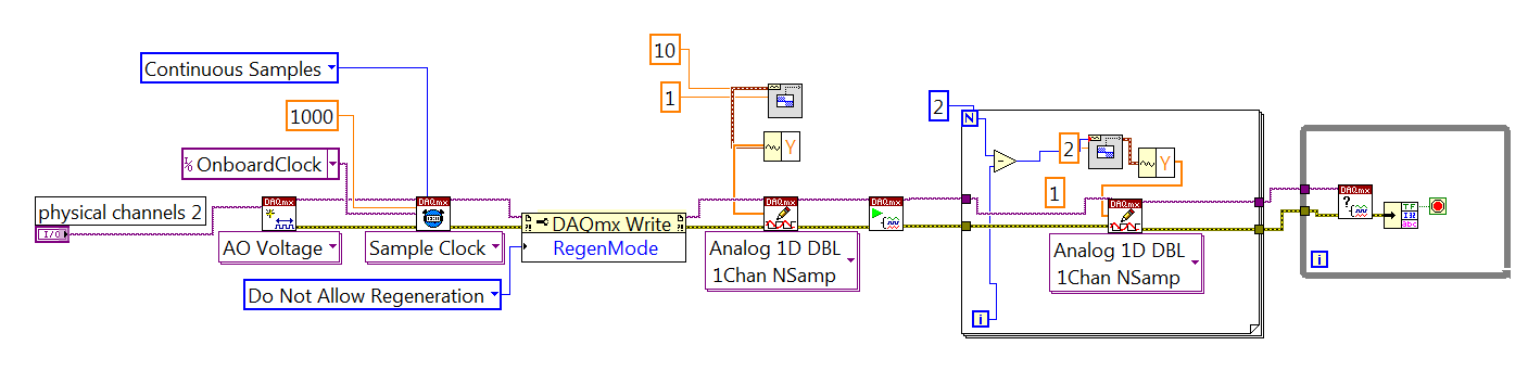

How to sens that there is no new data in the buffer when using continuous output, regeneration mode off
Please refere to the picture of my code. While samples are output, I am transfering new sample points in to the buffer. I want to close the task after the last sample is output. How can I achiev this?
At the moment it throws the error -200290. Meaing that there is no more data to output in the buffer. How can I finish the task in a controled manner?

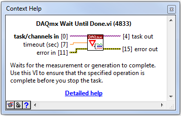

It is a continuous acquisition, the Wait Until Done VI will not return.
