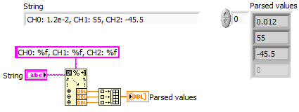

@Ouinon wrote:
For example, my string is: "CH0: float, CH1: float, CH2: float".
the only "numeric" in your example string are 0, 1, and 2.
If the "float" in you string are numbers, and the "trimmings" are always the same, all you needs is the following:
(1,313 Views)
Thank you !
Your solution is simple so perfect for me 🙂
