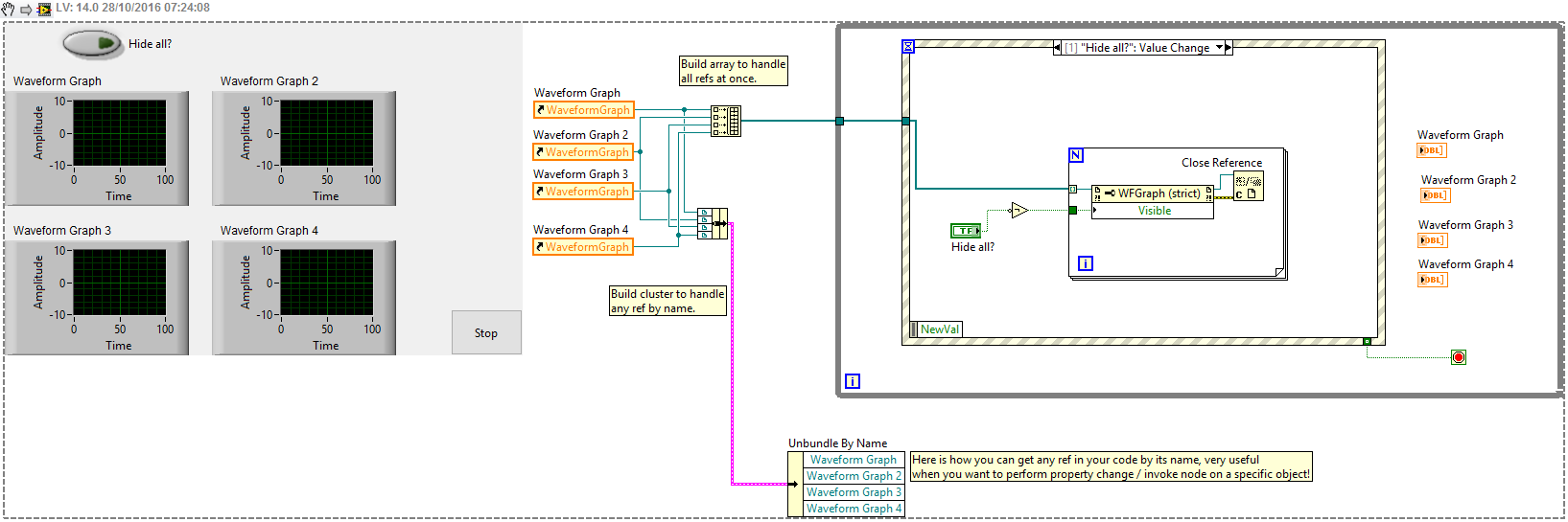

Anyway, if you really want to go in the ugly "overlapping objects" way, here is some help how to handle multiple element references so you are able to fire property nodes on a single or multiple controls/indicators. First, select all the elements you want to play with, on the Block Diagram. Then right click, and "create reference". This will create all the required references for your controls/indicators. See an example below how to handle references:
