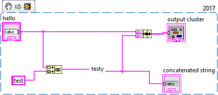

Thanks Gerdw,
If the below is what you mean, I tried it before posting but it didn't work.
In the output cluster indicator, the concatenated string doesn't have a label.  Am I doing it wrong?

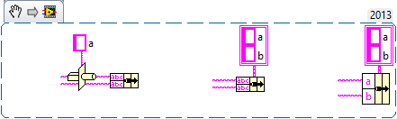

Of course if the goal is to label the elements of an indicator, you can also edit the names in the indicator. If the indicator is an output of a VI, the callers of that VI will see the names given in the indicator.
