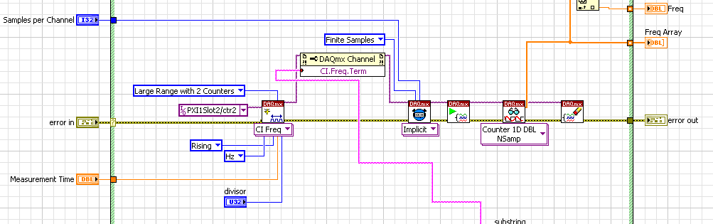

Hi John, could you please show me how can I implemnet the averaging method? I searched for it but I couldn't find any example
I might be ok with Large range method but then for any frequency value I need to change my meas time and divisor value but sounds like using averaging I don't need to change anything and I still have the least error
For example I see when the frequency is 50k then the divisor is 50 and when it is 5Mhz then the divisor is 5000. So I thought maybe I can use the following rule
frequency less than 1000---------->Low frequqncy with 1 counter
1000 to 5000..................> Large range with 2 counters ...divisor=5
5000 to 50000..................> Large range with 2 counters ...divisor=50
50000 to 500000..................> Large range with 2 counters ...divisor=500
500000 to 5000000..................> Large range with 2 counters ...divisor=5000
Could you please let me know if you think I can use these values ?
Message 7 of 8
(3,895 Views)
The two counter methods have generally fallen out of favor now that the sample clocked method is available with newer STC-3 based devices (though certain specific circumstances might still dictate their use).  This is the sample-clocked method I was talking about (adapted to run on all 16 input terminals, averaging is on by default):
The sample clocked method does not require setting a divisor--it will give you good accuracy and a uniform sample rate at all mesaurement frequencies.
A lower sample clock rate would give more accuracy, but at the cost of an increased measurement time.  In the example above I used freqout to generate the sample clock which has a minimum rate of 6250 Hz--you could use one of the other counters and go lower if you wanted to (accuracy calculations are in the X Series User Manual linked in my earlier post), iterating through all 16 channels only took about 50 ms total on my PCIe X Series.
