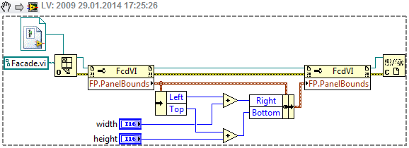

I know this is an old thread, but I had the same problem and found a solution, which is working for me. Maybe someone finds this helpful.
Open a reference to facade.vi and set panel bounds to your needs.
Well, front panel window might look strange.
UliB
