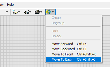

you need layers control
(3,295 Views)
Accepted by topic author 314159ym
Shift+Right click (the decoration), select the color tool at the bottom. Click the decoration, and select the top right "T" as color. Optionally, click tab to switch between the border color and the surface color of the decoration.
This will make the decoration transparent. If you want it on top of things, you need to send to front. If you want it behind everything, send it to the back.

Thanks,it works now like that
