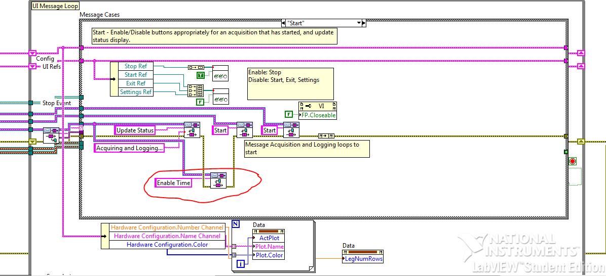

First, I add Enqueue Message for Enable time case

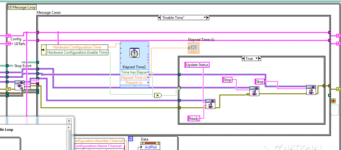

Then, I create Enable time cases and write box diagram fallow below pic.

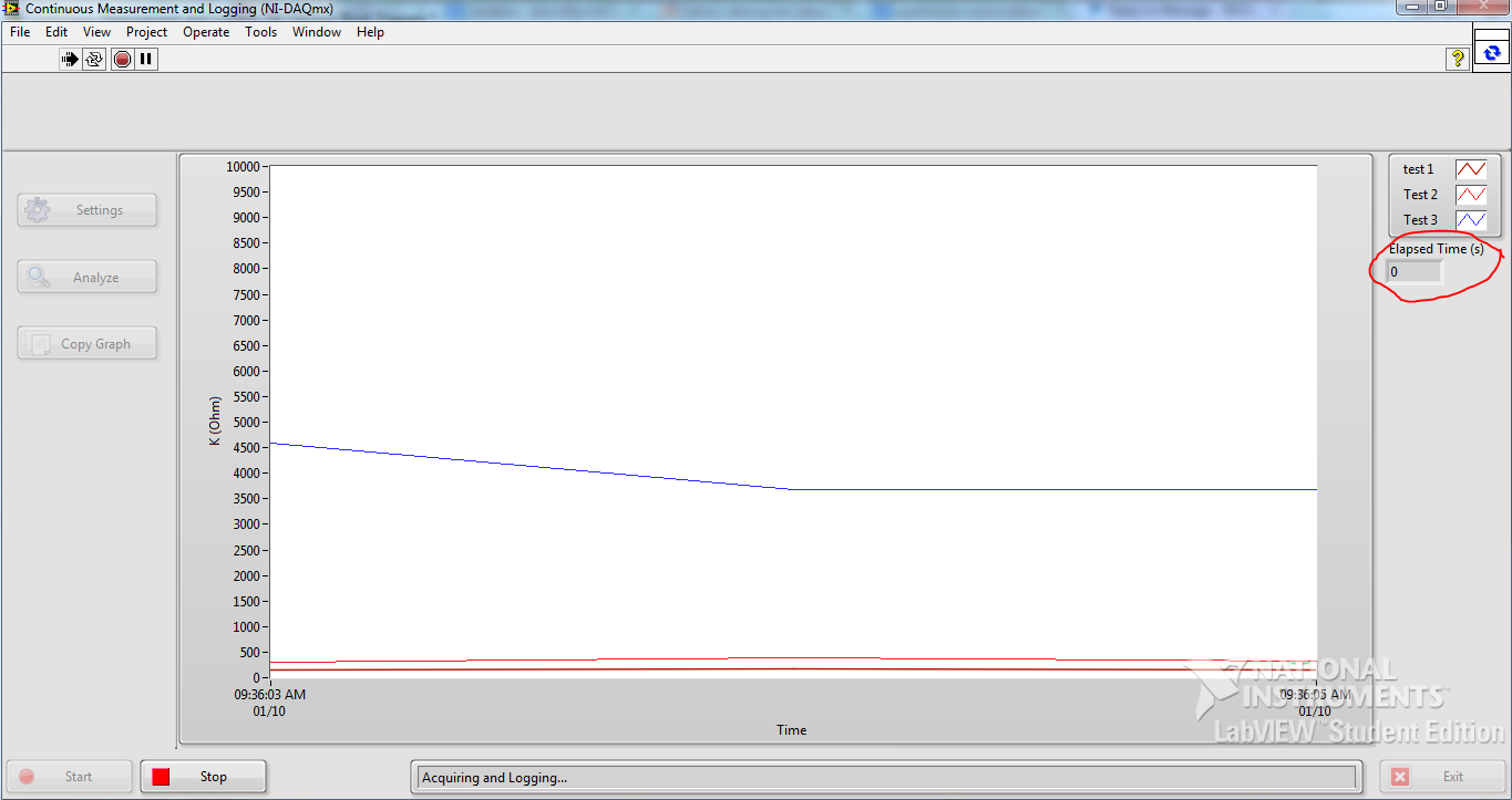

But when i run program,it don't work, time don't count
Please help me.

Hi 90110,
Do you have the Automatically Reset After Time Target enabled for the Elapsed Time.vi? This could be resetting the value of the indicator to 0.  Also, make sure the value you are putting in the Time Target(s) terminal is greater than 0.
I encourage you to use Highlight Execution (Lightbulb on the task bar) in LabVIEW to watch how your code is working. This could help explain the behavior you are seeing.
