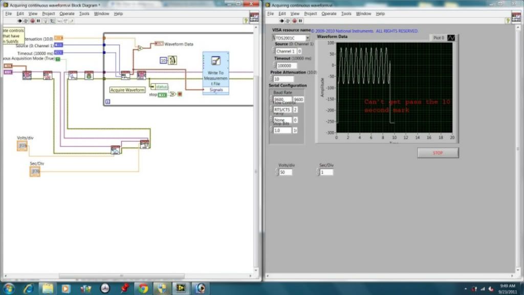

Hey Dave-C,
Thanks a bunch for your help. With your past entry I was able get some progress with the project however I've ran into another wall.
I'm using the 'Acquiring continuous waveform.vi' that you mentioned earlier and customized it by spcifying volts/div and sec/divs.
Currently, I have the o-scope connected to a standard sin wave function generator, but when I look at the graph and data points that labview returns it seems that every 10 seconds it reboots the vi. I've tried to go into the block diagram and edit the 'Timeouts' to 100 seconds so that it can continue graphing data past the 10 second point but no luck. Any help would be greatly appreciated.
Here's a link to a screnshot of my computer:
http://i44.photobucket.com/albums/f18/azniceblazer/Cantgopass10secs.jpg

Oops, I realize that the link in my previous post leads to a resized picture making it difficult to read anything. Here's another link to a better sized picture
http://tinypic.com/r/v3dmps/7

Hi Chron0,
I've taken a look at those functions, and I'm curious you've gotten into the Fetch Waveform.vi?  I found that inside that subvi there was a timeout that was a constant 10 seconds as well, which would precede the change in your top level vi that the screenshot goes with.  If you haven't already tried changing that, please do and let me know if that resolves the issue, and obviously if you have, please let me know and I'll see what else I can find.

Hey Dave,
Once again thanks for the response. I have gone in there and extended the timeout to 100,000 ms. What I have noticed is that if i set x as my sec/div then the graph will reset at every 10*x.
So if I try to set it to be 1 sec/div then the graph resets every 10 seconds.
Message 7 of 9
(5,180 Views)
The graph is supposed to reset every loop iteration. The timeout has nothing to do with it. Each time the loop iterates, you get a new capture and that seems is exactly what you are seeing. A graph does not maintain a history.
