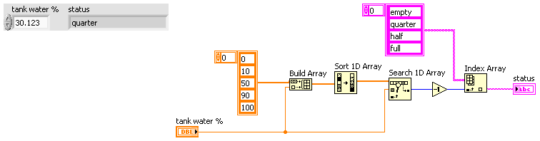

a different take without ranges....
since you used a double and not an interger, what do you think is going to happen when the % is between 10-11,49-50,89-90? using koenr example...

Thanks man thats exactlly what i wanted šŸ™‚
