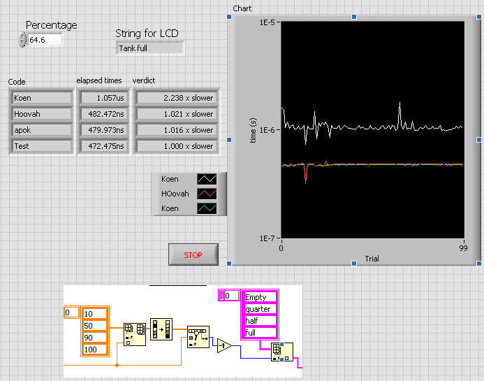

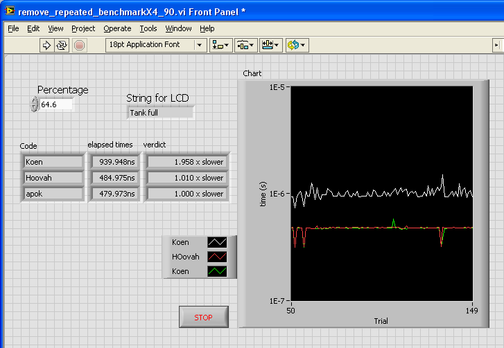

Checked it on benchmark (from altenbach).
As I already mine was the slowest, because structures take time.
Apok was slightly the fastest Smiley Very Happy

Though using insert into array instead of build array, will make it a very little bit faster. Using Apok's idea

I'll explain you the last one i posted with benchmark.
You have your percentage let's say 54. You add it to an array of the different turning points. Which are in your case:  10, 50, 90, 100 Plus your percentage 54
Then you sort the array which will give: 10, 50, 54, 90, 100. And search at what index this is: 3.
Now you know what index it has you will count it down with 1 because you've added an extra element.
Then you index the array of strings at the index you just found. The array of strings has to be in this order to work properly!
Hope this'll help you!

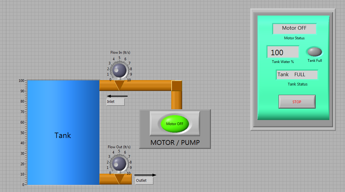

Below is the front end of my vi
