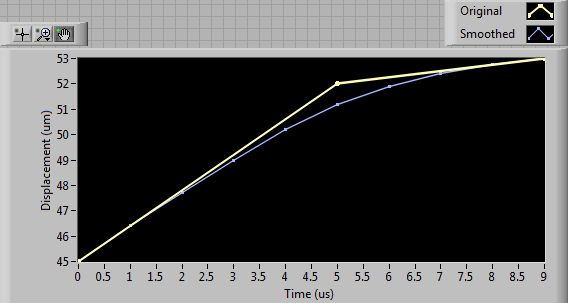

I've mimicked what I want to achieve by putting some hand-created numbers into this graph -->
The yellow line is my original profile data. You can see that I'll be moving the device from position 45 at time 0 to position 52 at time 5 and finally position 53 at time 9. This is fine, but I'd like to smooth out the motion a bit and avoid that nasty elbow at time=5 a bit.
The blue line is what I'd like. A smooth run from position 46 at time 0 to position 53 at 9 seconds, that preserves the velocities (gradients of the profile line) at the beginning and end. The reason for this is that the motor will arrive at position 46 (time 0) at the velocity inferred by the first gradient, and will continue beyond position 53 after time=9 at the speed inferred by the end gradient. Therefore I must not change the gradients of the line at the beginning and end.

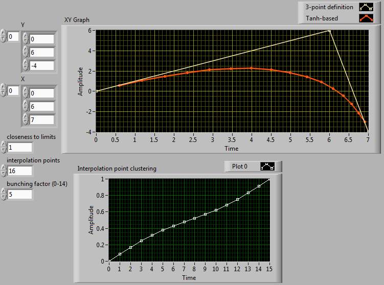

In the meantime I've re-nurtured my academic roots and developed myself a nice algorithm that happily smooths out an elbow defined by three points in space. It uses a proportional tanh relationship for the direction vectors, with a touch of sinusoidal clustering to improve the chord-wise distribution of interpolation points:
Thoric (CLA, CLED, CTD and LabVIEW Champion)

CC's best attempt at smoothing the curve was shown in this plot.
Using my non-legal technique, I got these results.
 I a nutshell:
When yo ufilter you loose data at the front and back-end with the number of points of data loss being determined by the order of the filer. By first pre-pending and appending the same data set reflected about the first and last point, we trick math into telling us what it woudl refuse to tell us otherwise.
