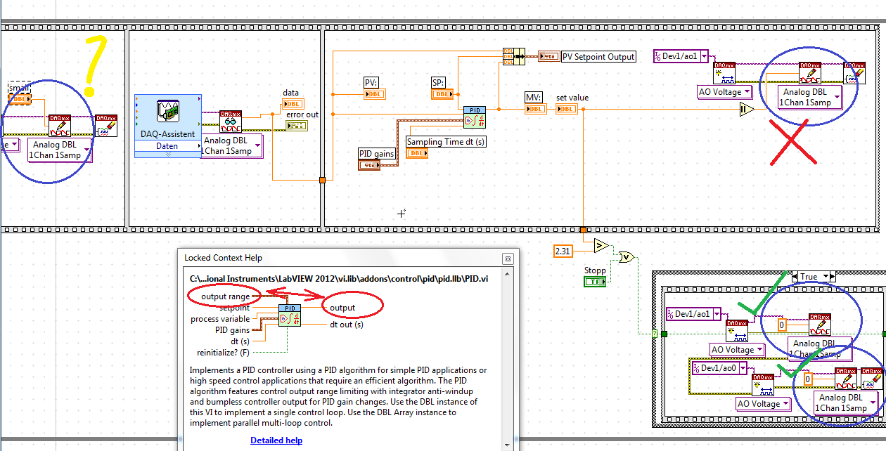

I have attached here my vi and the screen shot of error msg.

Check your code, You're writing analog voltages at four places (circled in Blue), out of which lower two will write '0' (zero) so it has no issues (Green check mark). If you see the left analog writing attempt (question mark in Yelow), where the code will write 'voltage for small actuator' value, you want to make sure that this value must be
"-10 <= value <= 10".
And last analog writing function is used in the third frame of 'Flat Sequence' structure, that is certainly causing issue, because the PID VI's output will be any value between -100 to 100 (PID VI's 'output' always depends on the 'output range' input of the same VI).
Now either you can wire 'output range' input to PID VI or you want to coerce the 'output' of PID vi to a range of -10 to 10 before it goes to Analog wirte VI.
