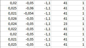

I am working on a project where I receive a string of numbers continuously from Arduino via com port using Visa. I've converted the string into a 2D array of 5 columns (5 different data) and n number of rows which gets updated continuously as long as i run the program.
have a look at the below array (example),
whenever the value of the 4th column is 23, i need to make a LED glow for 5 iteration regardless of the value in 4th column. problem is, i am able to make the LED glow for only the iteration where the value is 23. but, as soon as the value changes to 41, my LED is turned OFF.
can anyone tell me how to program this??
