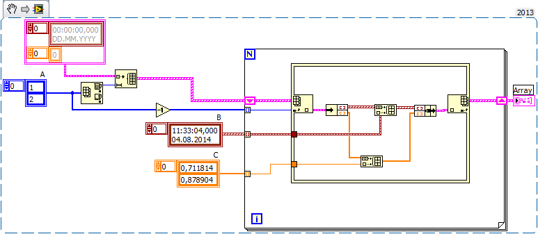

Something like this?
Message 2 of 11
(5,169 Views)

No, the array-size of the output array equals the size of different numbers in array A.
In your screenshot the values of  B and C in index 2 should appear as array under index 0 as they have the same number in A.
A:
1
2
1
2
B
2009
2010
2011
2012
C
10
11
12
13
Cluster[0]
1
Timestamp[2009,2011]
Value[10,12]
Cluster[1]
2
Timestamp[2010,2012]
Value[11,13]
The values in A are not always in a order. They can be mixed like [1,2,1,2,1,1,1,1,2,2,1,2,1,2,2,2,2,1,1,1]

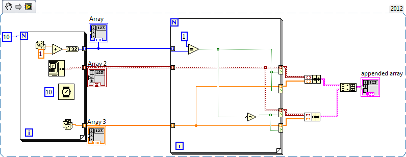

How about this one:
Regards, Jens

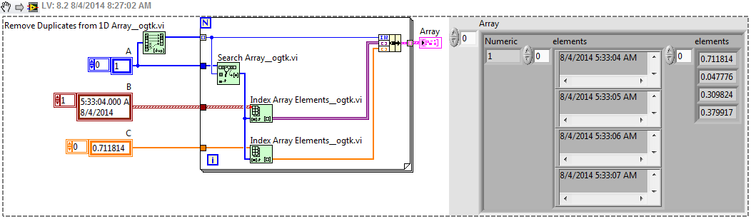

Accepted by topic author OnlyOne
Here's a simple solution that uses the OpenG array tools.
Jim

Hi jcarmody,
where did you get this library? I just downloaded my version from http://lavag.org/files/file/169-openg-array-xnodes/ but i have different in/outputs of the vis...
Thx

here my (not so flexible) solution using conditional indexing ...
I canceled my first try , so I thought I should provide at least another solution 😉

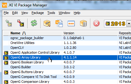

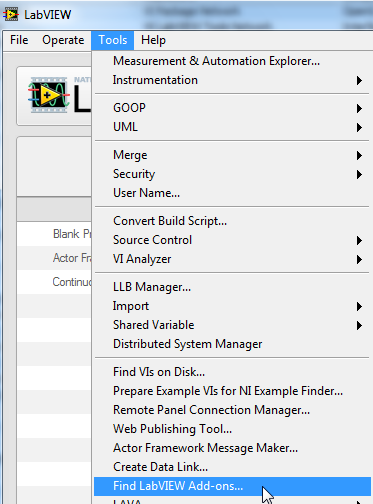

Install the OpenG Package with the help of the VI Package Manager.
Regards, Jens
Jim
